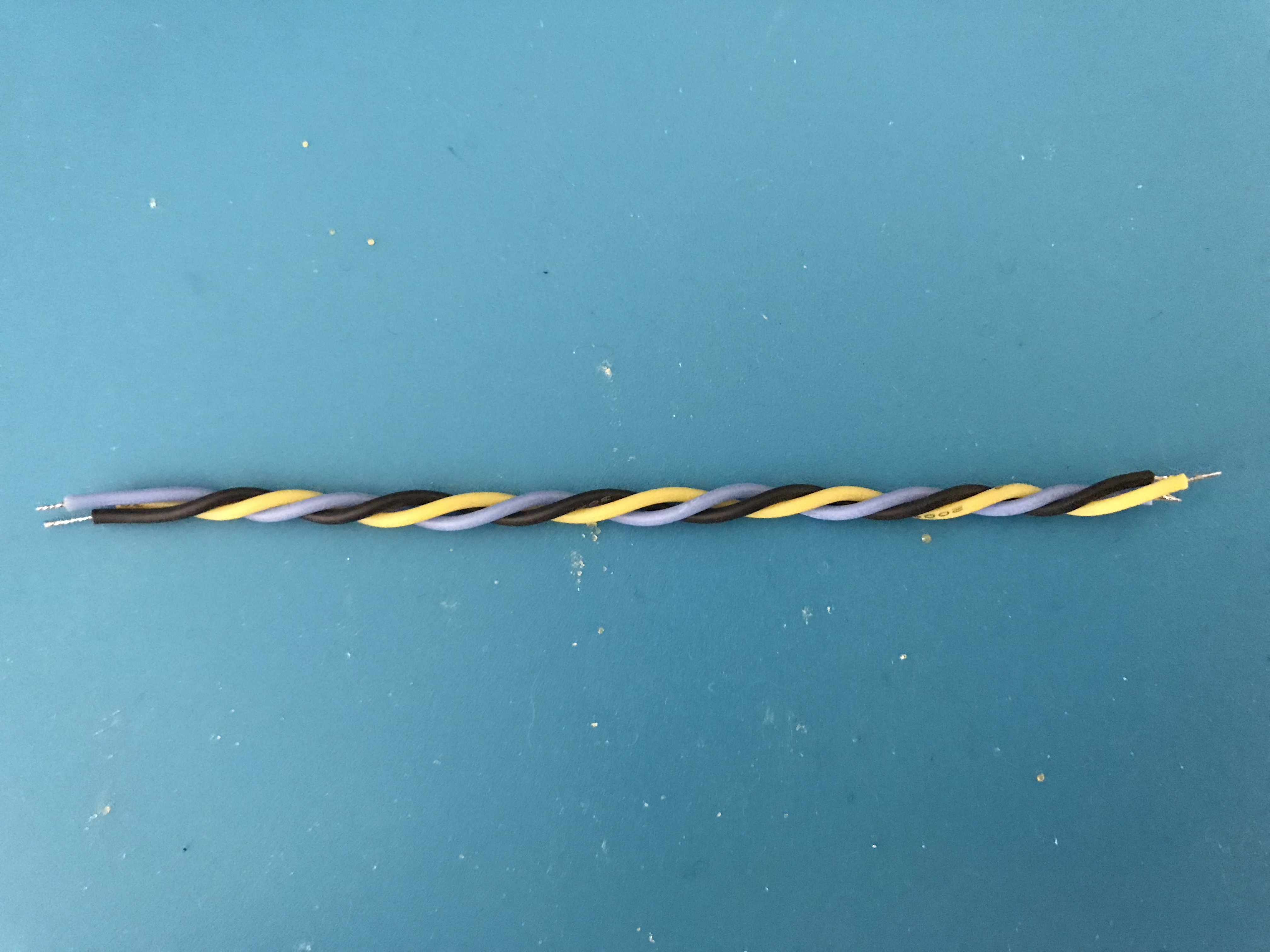

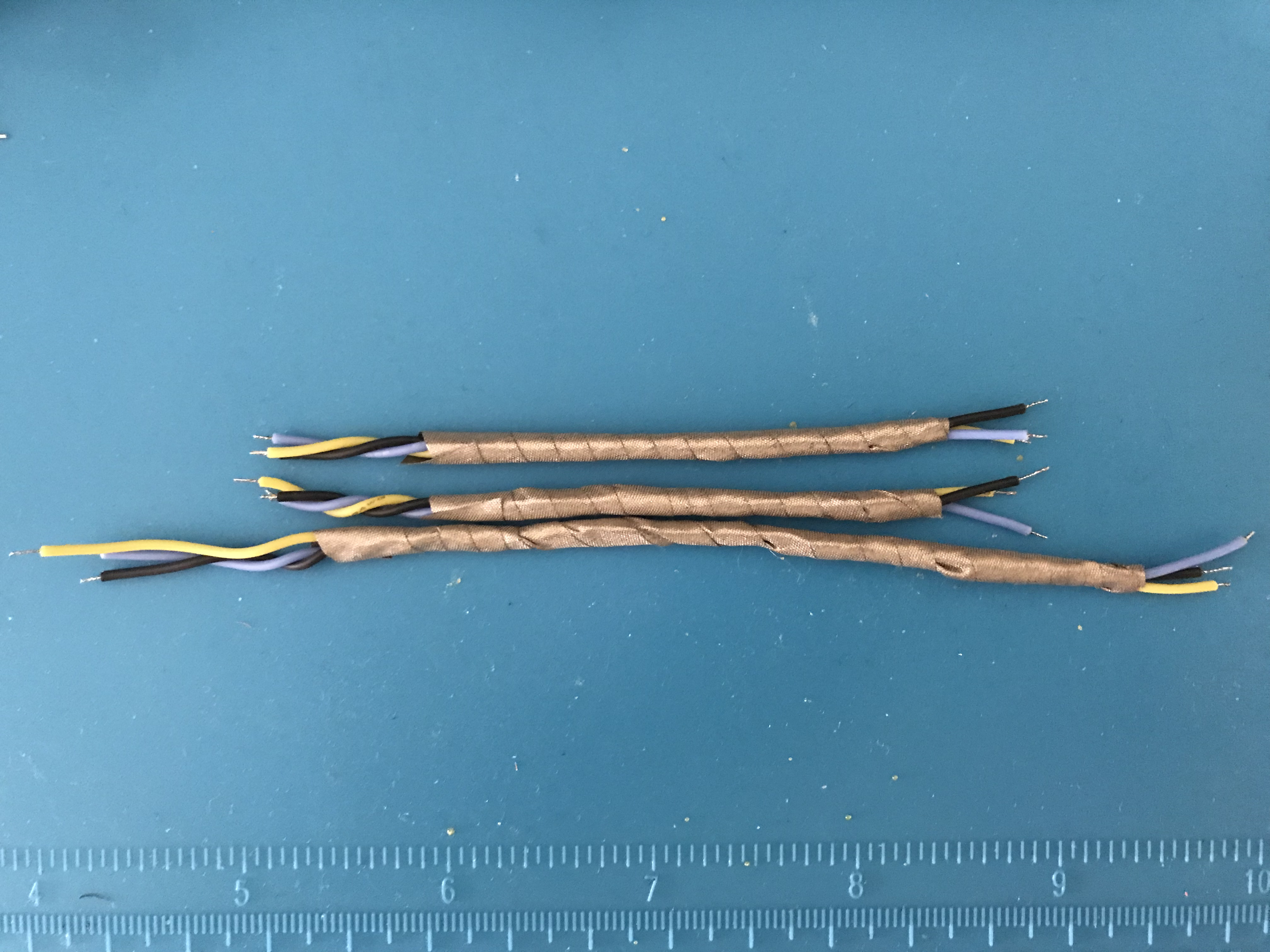

I almost completed my project too, I also used a core M3.
I'm having trouble finding a double coil to eliminate the noise from the audio amplifier that fits in the chassis of the Nintendo switch. Any suggestions?
Re: WII U Intel m5 Console
Post by YaYa » Wed Nov 21, 2018 1:33 pm
Use shielding fabric tape and wrap all the audio wires with it to create a shield around them... Also, twist audio wire together before wrapping them with the shield
Post by pais83 » Wed Nov 21, 2018 2:09 pm
WoW! nice trick, I will try It tomorrow.
This is my audio wiring. Banjo has used a coil in the power supply of the amplifier, but the Nintendo switch chasis is so tiny.
Post by pais83 » Tue Nov 27, 2018 3:13 am
Thanks Yaya! Your trick works fine, and now the sound is clear.
Post by YaYa » Tue Nov 27, 2018 3:28 am
Awesome ! Glad that it helped :D
