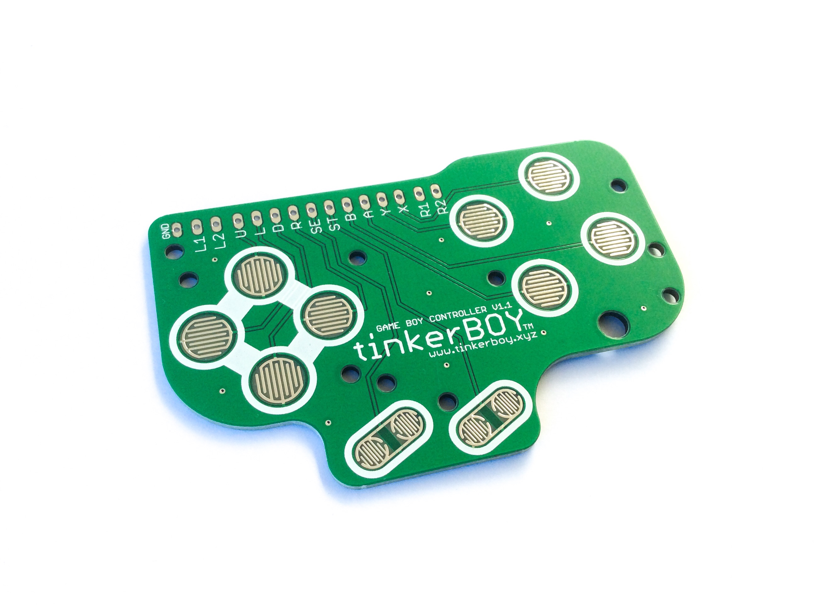

You might be interested with my newly released tinkerBOY PowerSwitch with Safe Shutdown. It’s like a powerboost but with higher power capacity.
And yes my v3 uses a usb audio chip with builtin amp. It’s got battery monitoring feature too.

So Tinkerboy, does the V3 with the 6 button layout make the rear buttons obsolete?
- tinkerBOY
- Posts: 710
- Has thanked: 294 times
- Been thanked: 206 times
Re: Where the F#*k do i start?
No, you can add 4 rear buttons if you want along with a 6-button layout.Michael8t1 wrote: ↑Thu Sep 05, 2019 1:34 amSo Tinkerboy, does the V3 with the 6 button layout make the rear buttons obsolete?
