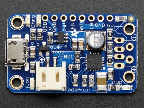

Adafruit Powerboost 500C
Pros:
  • Slightly Cheaper than the 1000C
  • Usually easier to get than the 1000c
  • Check Cons below, is otherwise identical to the 1000C.
Cons:
  • Can only charge at 500mA (half the 1000C's rate)
  • Does not have the same "Load Sharing Circuit" claimed by the 1000C
  • Is not suitable for charge & play

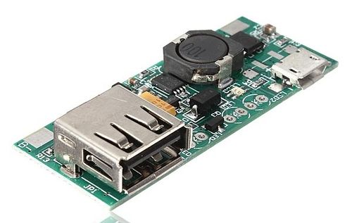

Banggood Model
3.7V Li-ion Battery Mini USB To USB A Power Supply Module
Module is able to power a device and charge the battery at the same time.
Pros:
  • Fraction of the cost of the Adafruit models.
  • Almost always available.
Cons:
  • Excessive shipping times (20-30 days to USA).
  • Not as well documented as the Adafruit Models
  • No Low Battery function on-board, outside monitoring is required.
Has LED lights to indicate the state:
  • Red led: charging
  • Green led: finished charging
  • Blue led: board is powering a device
