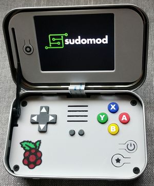

MintyPi V3

Build Guide
You can view the build guide video from the following link: https://www.youtube.com/watch?v=YqE2x-0JYzs
Please watch it fully once or twice before attempting to build your MintyPi V3 so you know what is coming!
