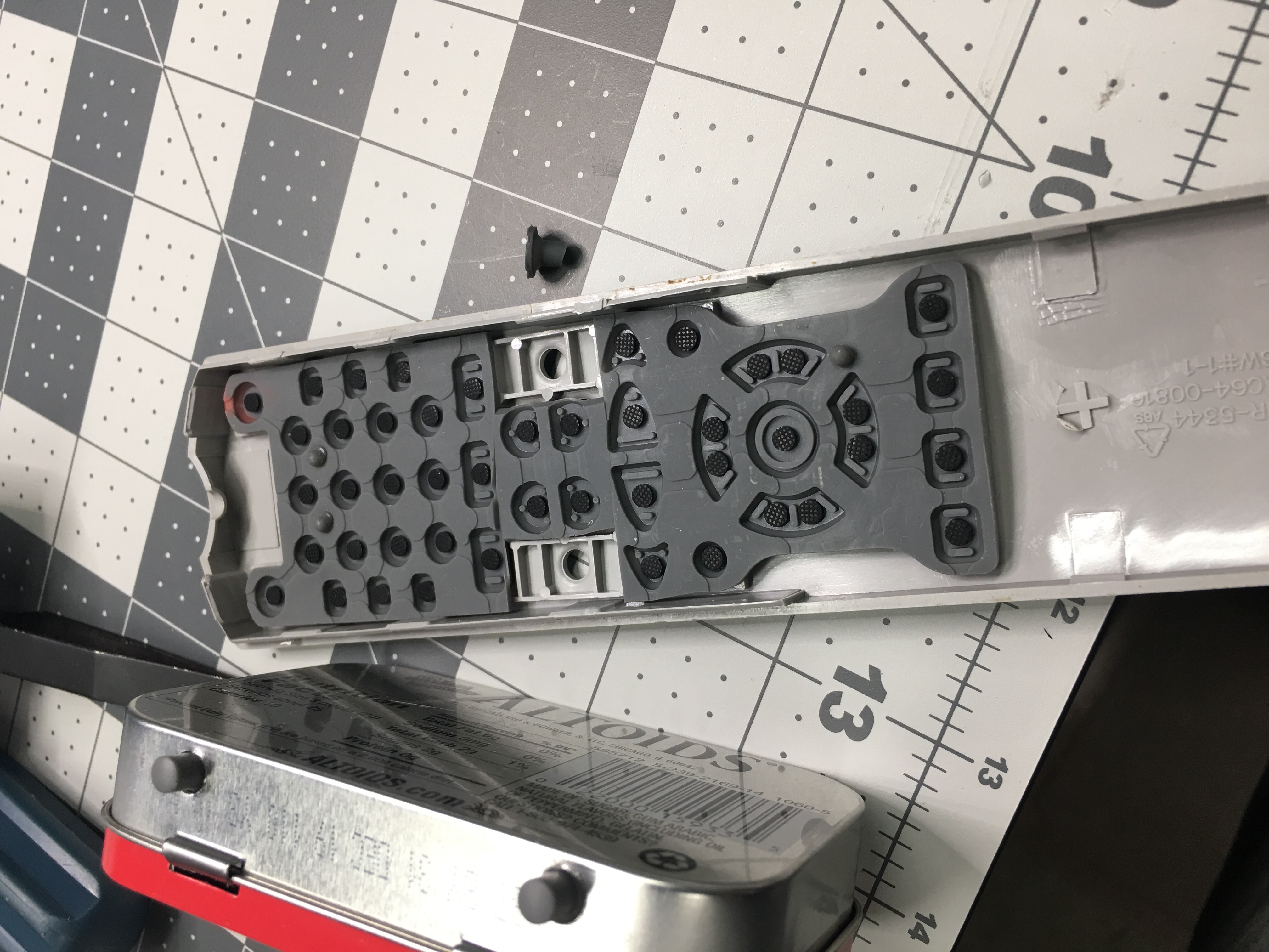

I had this exact issue. I ultimately lost one of my buttons. I ordered a new set from wermy but figure it would happen again.
My fix: I have a dozen old tv remote controls around the house. I found one that had a few button the right size and color and cut down the membrane to fit and give them more staying power in the tin.
Also this dramatically improved the feel! They are not mushy anymore.

Here is a picture of my remote buttons with the last remaining kit button I could find.
The pads on the inside are left large to keep them from pulling out again. You can see how large I left the membrane from what missing in the remote and how small the standard button is.
