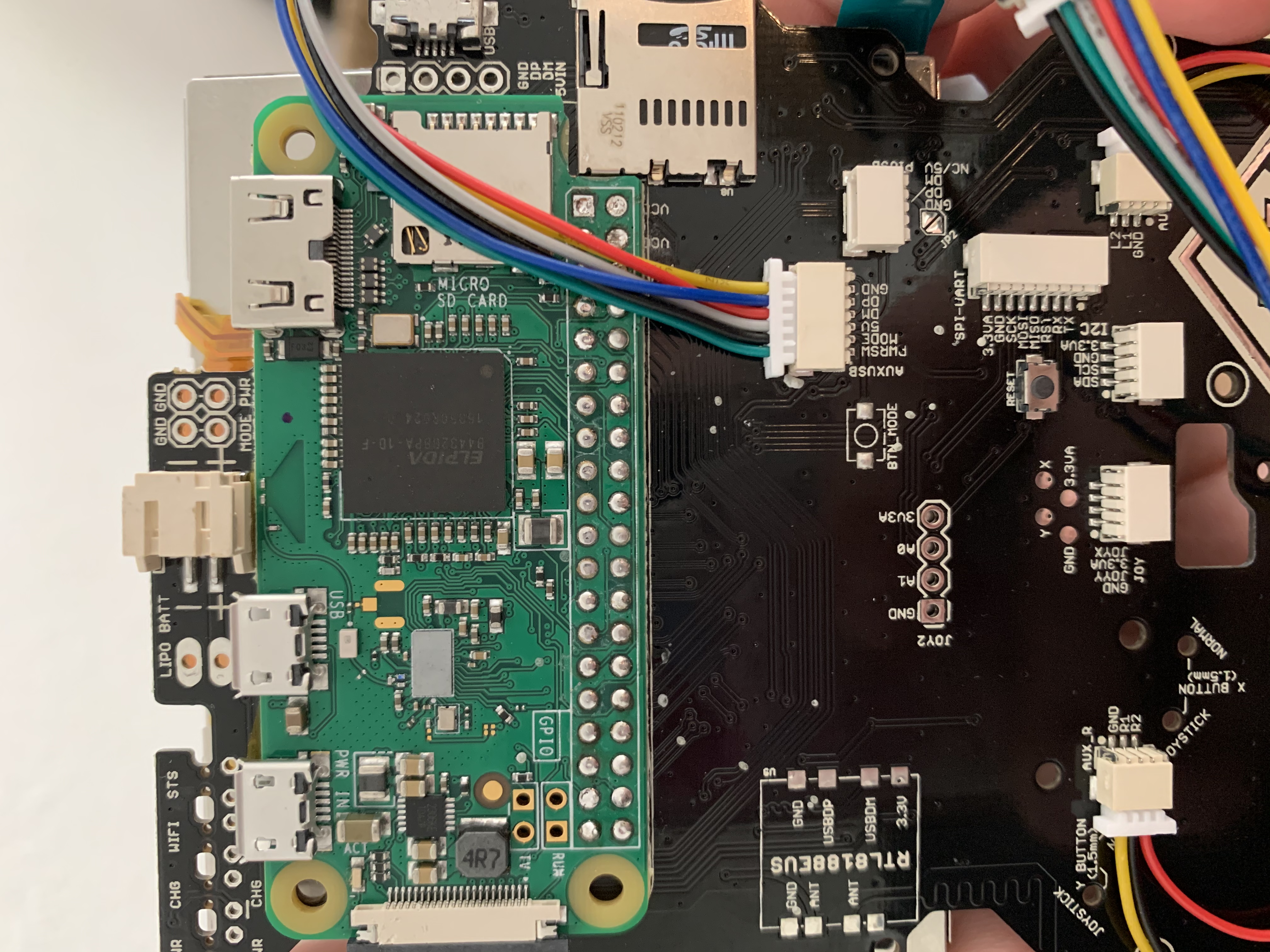

Picture 1 is my stuff all plugged in correctly :-)

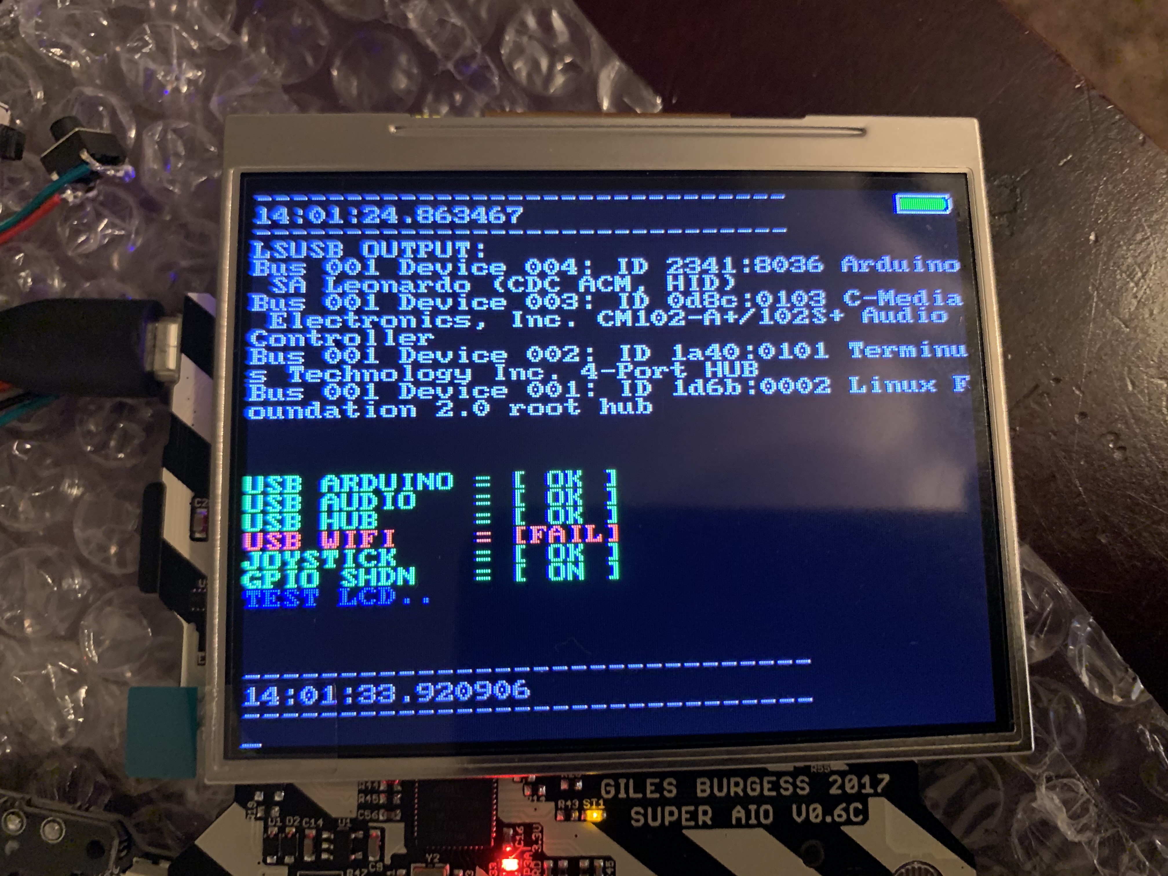

Picture 2 is my unit in Tester Mode with what are the expected results according to the SAIO guide.

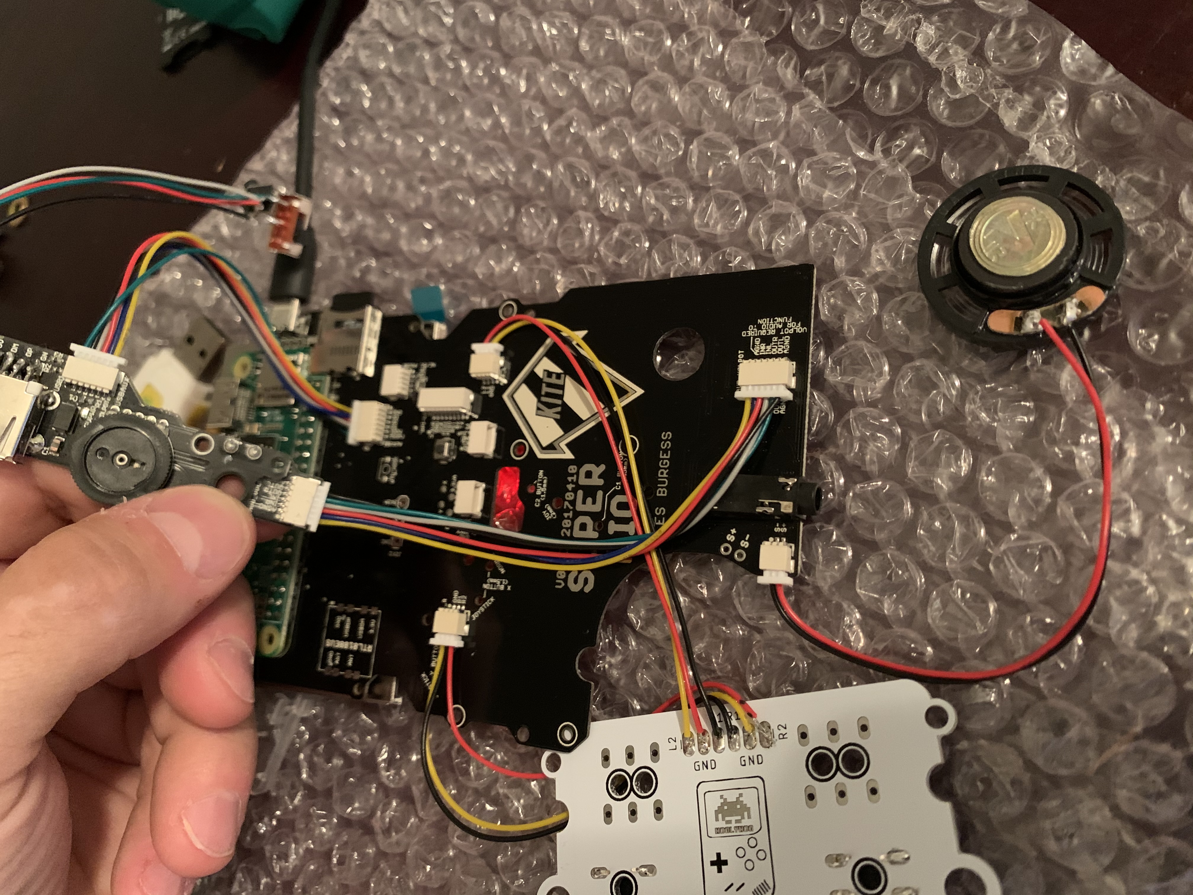

Picture 3 is what I get when I press the "mode" button - only that one (STS) LED lights up fully.

1) WIFI: Which version of the Pi Zero do you have? I can't quite see from the pictures. There are two version, the Pi Zero and Pi Zero W. The latter HAS on board wifi, the other doesn't. The FAIL is on USB WIFI, and looking at the board the footprint for the USB wifi module is missing (because this board didn't have it populated due to recomending the use of the Pi Zero W. The USB module should be this https://www.aliexpress.com/item/32817961824.html

1) My order was for a Zero W and based on pics online, I am pretty sure I have the wireless module (added Pic below).
