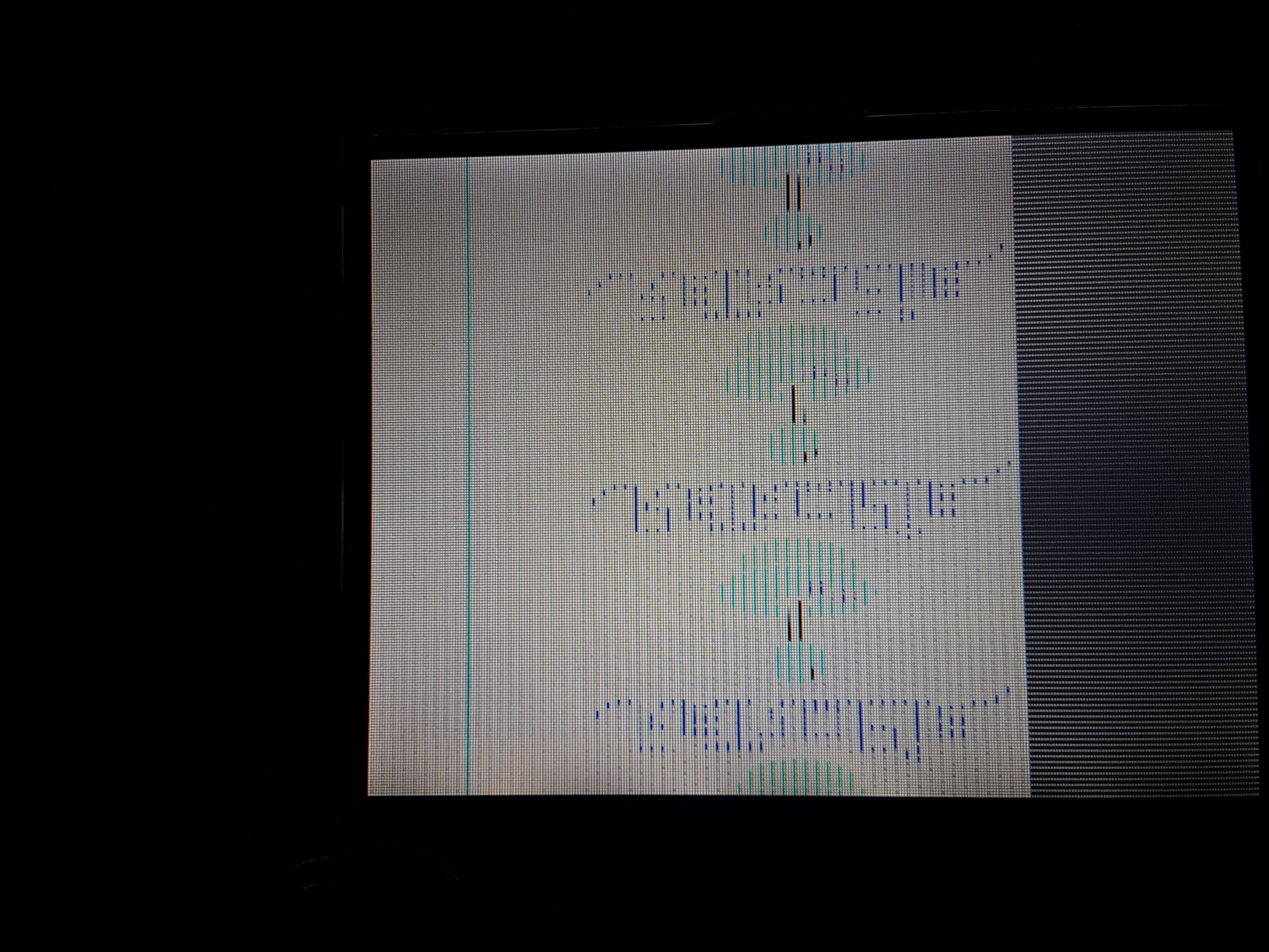

I have finished the inital soldering my v3 mintyPi, have tested connections, and rechecked all my solders. Still getting the same video distortion when i plug it in.
Attached a photo of the distortion. Would love to hear any thoughts, thanks.

Thank you for the suggestion Trubl. Sorry for the lag in my reply.
Yes, I tried that image and had the same distortion.

My last screen I got from Ali for my Gaboze Pocaio had a similar problem and I got a replacement screen and it worked great. That might be an issue.

Whoops, image was right, switched to etcher to burn image and everything is good. Thank You Spyder and Trubl for your replys.
