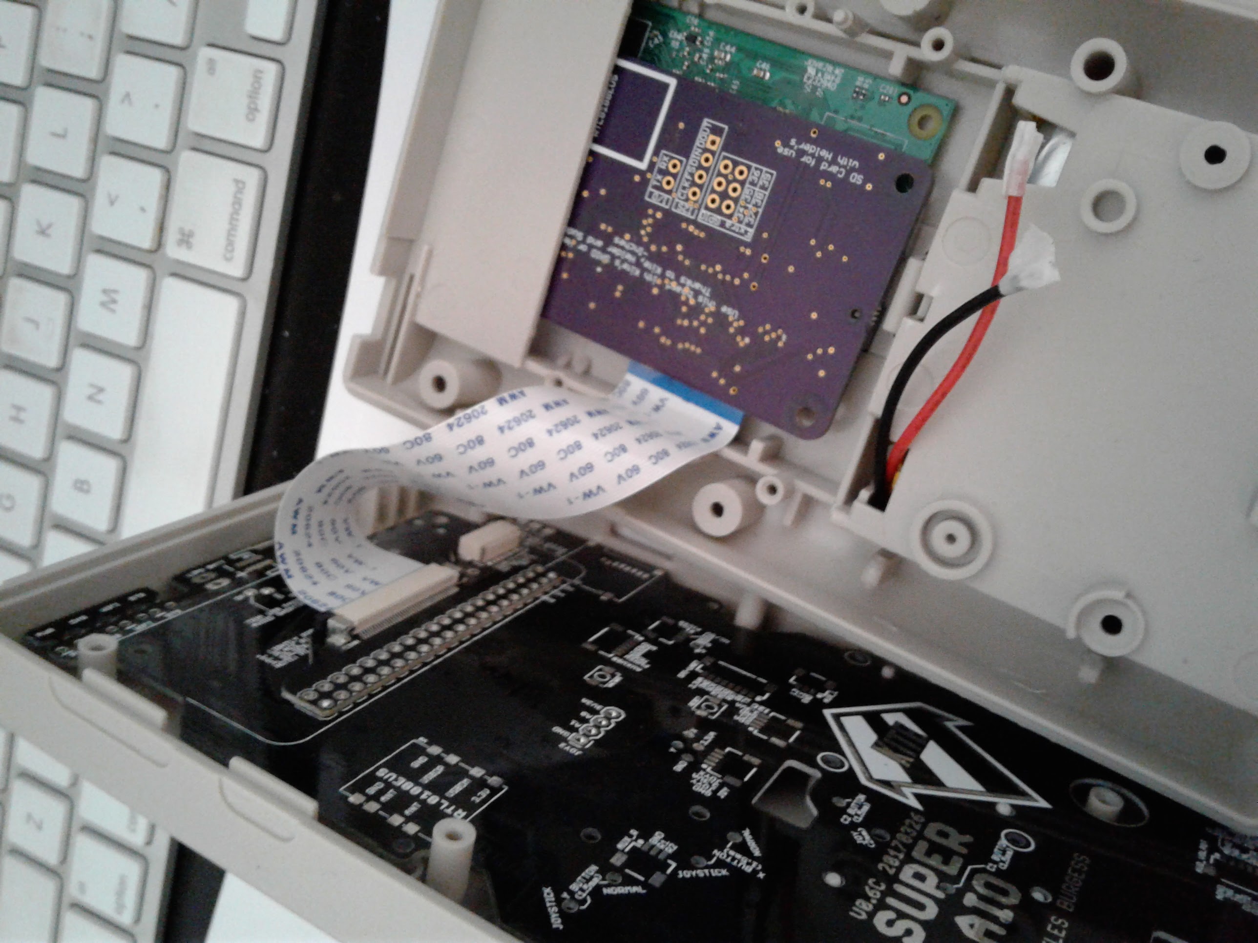

Maybe you can consider putting the CM3 facing outwards so the shell can have some openings there for cooling or even a fan sitting on top of the chip?

It looks as if that would work as well if you decided to go that route. You might need to cut the battery bay and use magnets like in Kite's build. Ultimately you can put this wherever you would like to provided you find a comfortable spot to keep the FPC cable happy. The first option is just where it fits best. I'll have to run it a while and check temps once I get the SAIO board in.
If you are building with Helder's AIO then you have many more options because the FPC cable will not be a limiting factor.
Otherwise if you use the original orientation you can put a fan in the cart bay and you would probably move a lot of air around successfully.

I highly reccoment this FPC Cable as it is flexible. it gives you alot mor options about placement.
Used this in my build with Saio and pi 3. worked really well..
