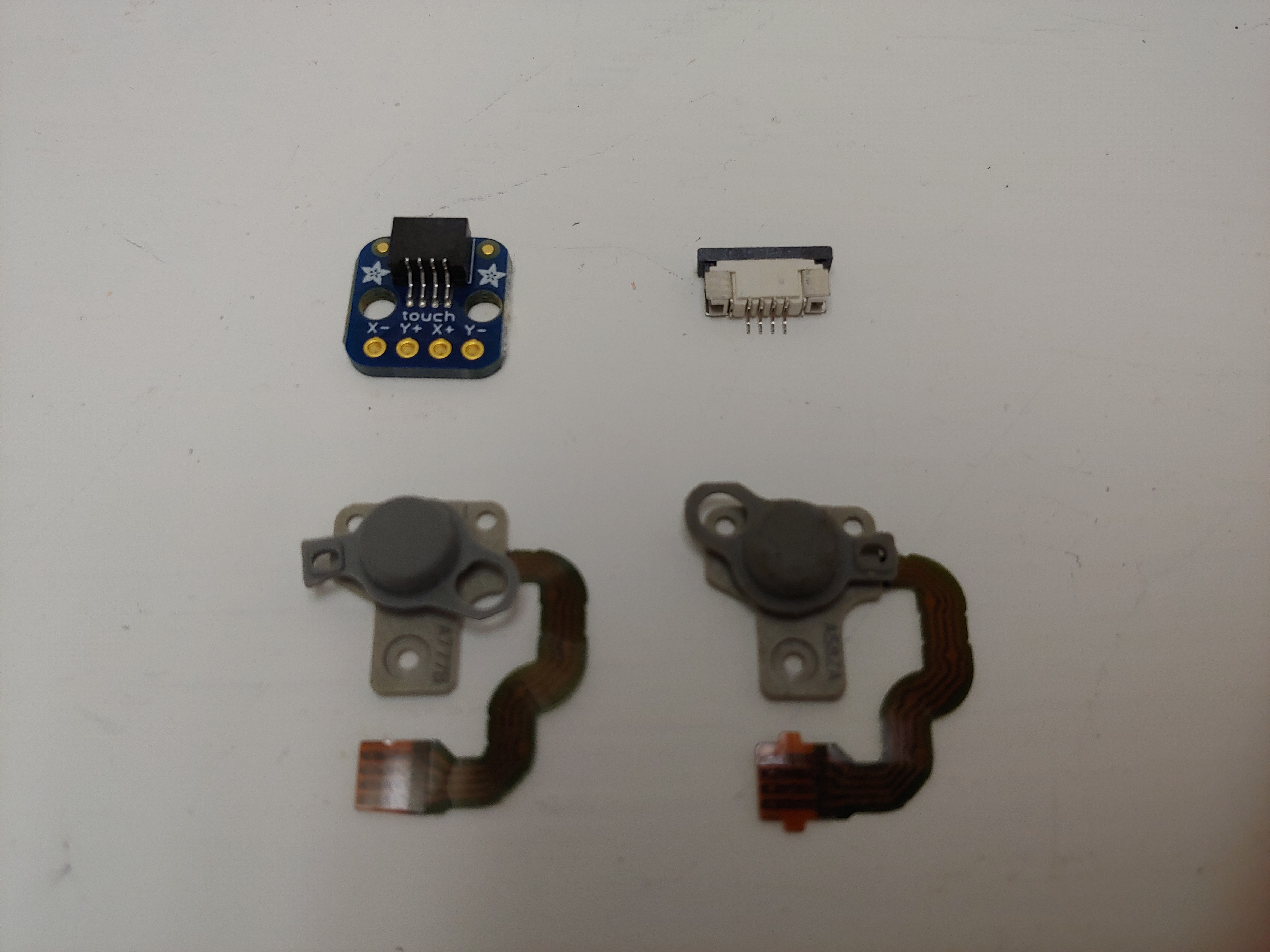

Long time lurker, I've recently ordered two 3DS C-Sticks, and have been doing a ton of research to look up any diagrams on them whatsoever, so far not so much. I've put this album together: https://imgur.com/gallery/MxZRyhJ , I think I've figured out the layout, but any help would be appreciated. I think, from first, top down image perspective, its X,GND,Y,Vcc. I'd really like to use these in an upcoming build I'm making.
Thoughts?

Ok, both C-sticks have arrived finally, as well as the little sockets, got two different types for testing. To get the ribbon to fit in, I had to cut the "wings" off. Perfect so far.

Also a long time lurker -- but did you have any luck with that? :) I was thinking of doing something similar.

Hello guys. Is there anyone that was able to find 5pin 0.5mm fpc adapters ?
How do you fix in place a 5pin flixible cable into a 6pin 0.5mm fpc adapter ?
