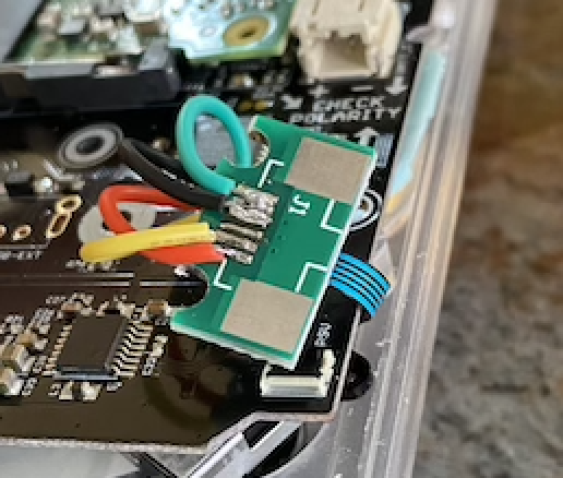

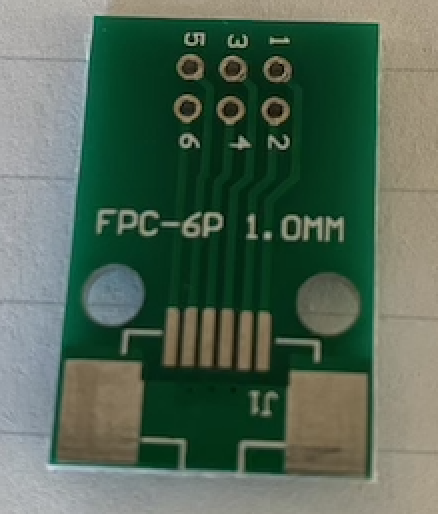

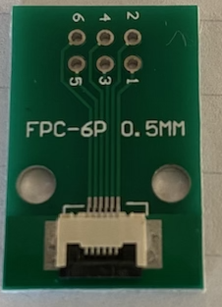

I've been working with the Kite Circuit Shield and I wanted to use a Nintendo Switch joystick.

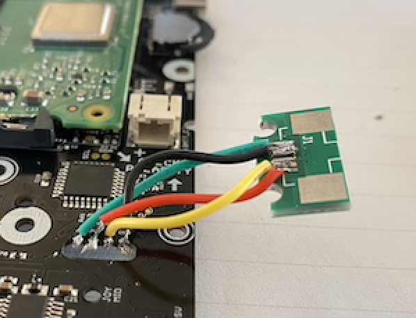

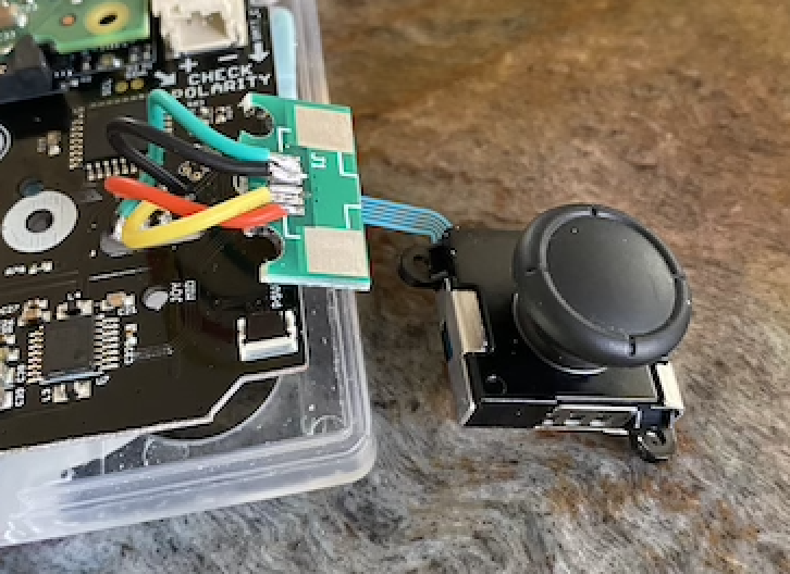

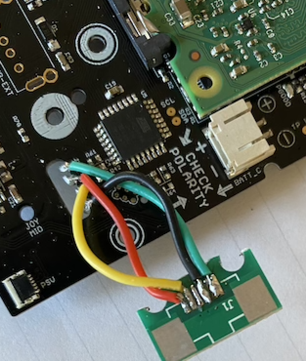

I have the FCP-6P 0.5MM breakout board for the ribbon cable, but I have the board flipped so I'm soldering to the pads underneath. So far I have tried soldering the pinouts in 2 ways. The first way is following the original Kite post where pad #1 is VCC, #2 is Up/Down, #3 unused, #4 GND, #5 Left/Right, #6 unused. This didn't work and I realized the numbers are flipped from the other side, so #6 would be #1 and so on. I tried reversing the pinout and that still didn't work. Can someone here look over these pictures of my soldering and see where I might've gone wrong?
In my images:
1. Red -> VCC (aka 3V3)
2. Yellow -> Up/Down (aka Y)
3. Empty
4. Black -> GND
5. Green -> Left/Right (aka X)
6. Empty
The two sides of the breakout board I'm using. In the first image, the opposite side of the hole #1 is actually what we've been calling hole #6.

This is my solder job. I know, not the best. I made sure to put the ribbon in upside down.

I know a lot of time has passed since you posted this, but in case anybody else has the same issue;
The only vias I see in that PCB are on the end opposite to the ffc connector, where’d you’d solder a connector or bare wires. I believe by cutting the board you have disconnected the top and bottom traces from one another.
